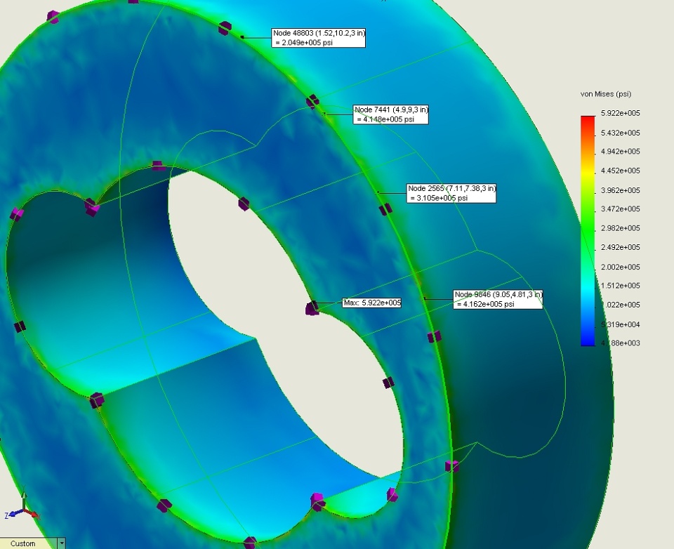

I've attached a typical result from a face contact test. Theloading face (not shown) is larger in diameter than the die face(shown). Loads are extremely high as is common in this application.I'm having trouble deciding if the high local peaks (400ksi+) oftenfound radomly at vertex nodes can be ignored in favor of theresults shown in the color chart. These appearent singularities area common occurance especially on complex geometry.SolidworksSimulation

In my experience with FEA, using triangular meshes likeCOSMOS does results in erroneous results around sharp edges asopposed to using quadrilateral meshes like better FEA programs cando. Like you said, the tri meshes produce a singularities on sharpedge. I usually ignore them.

if your objective is to determine the maximum stress, then thedecision to analyze a model with sharp corners is a very seriousmistake. According to the theory of elasticity, stress in the sharpcorners is infinite. The finite element model does not produceinfinite stress results due to discretization errors, and theseerrors mask the modeling error. However in the vicinity of sharpcorners, stress results completely depend on mesh size. Theseresults are totally meaningless at these locations.
If your design intent is to determine the maximum stress you mustinclude a fillet, no matter how small it is.
If you want to check if your FEA model is correct check theconvergence of the displacements results. Usually they convergewhile the stress behave differently.
Hope it is clear and helpfull
SF
SF 2009-03-17
If the high nodal stress is distributed on more than four orfive elements, i will consider for failure criteria. If it isconcentrated on one or two element, i will ignore it.
We normally dont use model with sharp corners. As Gianlucacommented, we normally use fillets on sharp corners.
I suggest you to probe the stress results on all the nodes [Two tothree layers]close to the high stressed node. If the difference ishuge say above 20% then ignore the high stressed node. If thedifference is less, you should include for failure criteria.
Correct me if i'm wrong.
SF
SF 2009-03-17
Thanks All, Seems like there's agreement that under certainconditions, peaks can be largely ignored but a radius properlymeshed will yield more consistent results. My results are based onh-adaptive mesh convergence. As I recall, the polynomial adaptiveconvergence was very similar. I agree that a sharp corner increasesthe modeling error but I have seen similar results on small radiiat the tangent of the radius. Often model errors are generated bysmall radii as a result of oblique tetrahedrons combined with peaksat the tangent. I will experiment with a radius and increase meshdensity as needed and see if results are more consistent.
