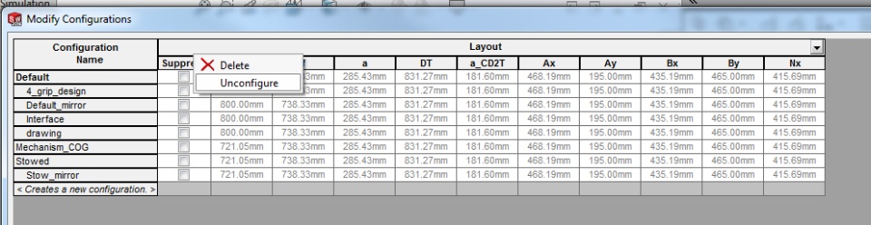

hi,
I have top level assembly that contain sketch wich is referenced by parts that are 2nd level children of that assy
The sketch dimensions are edited by design table. (copy/paste from Excel file Im using for my design)
The assembly contain several configurations that were driven by the design table.
I'm no longer want that the sketch dimensions will vary b/w configurations, only suppres several components
I tried to press the 'Unconfigure' button in the 'Modify Configurations' dialog box and the sketch dimensions did not change back to the default (it was the active config while pressing the 'Unconfigure' button).
Now, when I edit the dimensions in design table(contains only the default config), it dosen't update the dimensions in the other configs
Can it be done w/o adding the other configurations to the design table and set them to the same value?
Thanks
David

Thank you all for responds
the dimensions in the sketch getting their values from the design table...
I made a copy and delete the design table,
then unconfigured the sketch dimensions (and chek that 'All Config.' was set in each dim)
then re-created the design table (used the copy I made)
it solve the problem and now sketch dimensions changes in all configurations as the defualt changes
