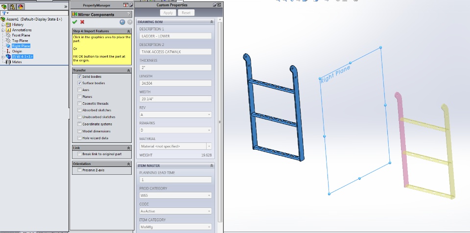

This is an example assembly.
The part highlighted in pink is the one I am creating an opposite hand version
Notice how Custom Properties is NOT one of the options under Import Features menu so I don't know if its checked or unchecked? I'm guessing its checked by default?
In 2013 when I used to mirror assemblies like this Custom Properties was one of the options to check/uncheck under Import Features menu

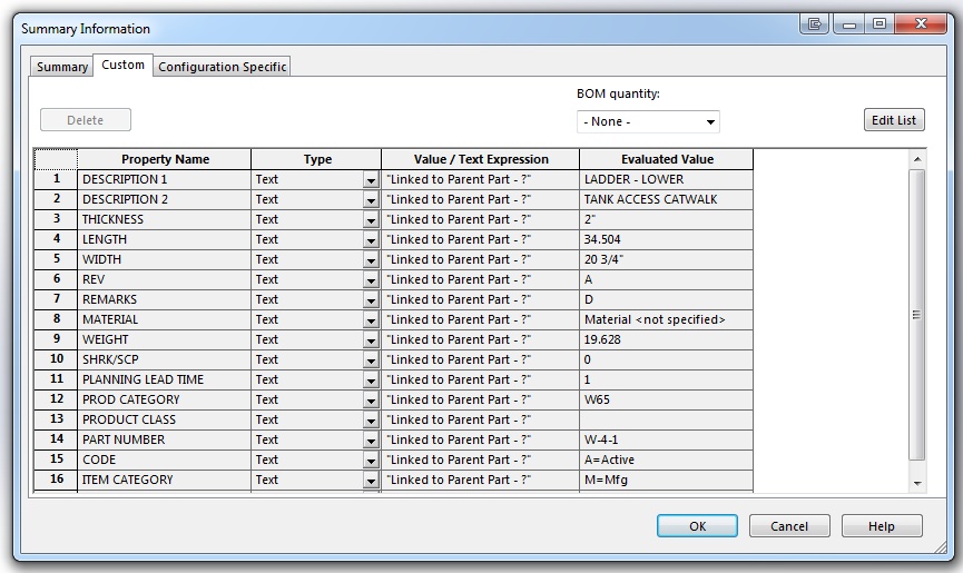

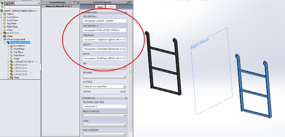

So this is what I get for both the assembly and the opposite hand version part.  fromparent+ for all the custom properties.
and this shows how they're not changeable
I cant erase them, I cant edit them... see how they're greyed out?
This is a real problem because these custom properties show up in our BOM, and the assemblies and parts that need to say RH still say LH and we cannot change them!
