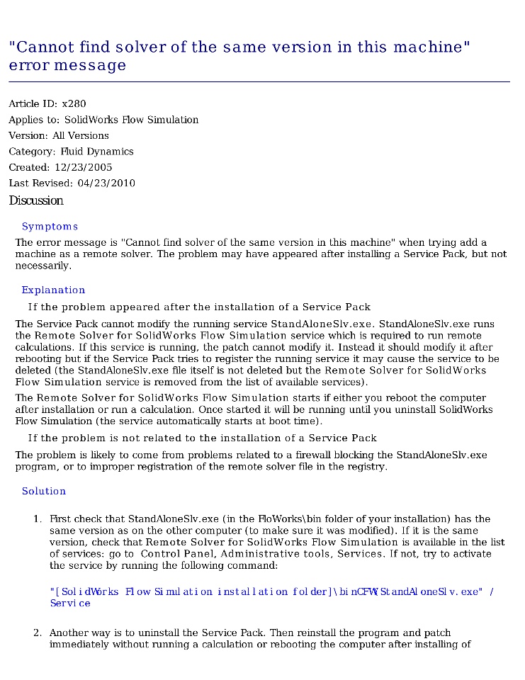

I am trying to use the Remote Solver in Flow Simulation 2010 and I get the error "Cannot find solver of the same version on the computer".
The computer I am trying to access has the same version of SW and Flow Sim and is on my school network. I have completely turned off the firewall on both computers, made sure TCP port numbers match.
No matter what I try, the error message persists. Please share some ideas as I am out of them.

SF 2011-05-26 Best Answer
I found this PDF document on the knowledge base on this issue it is dated 2010.
