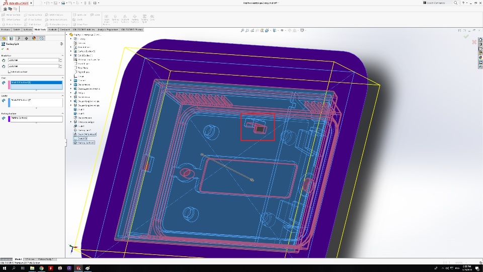

Im trying to create a tooling split for model that i made some design changes for. First time all was alright now i have trouble making the tooling split.
When i try with "INTERLOCK SURFACE" i get error : "Failed creating core and cavity solids" and when i try without: "The parting surface must be larger than the boundary sketch."
Is it because of this holder being having surfaces in both cavity and core ?
The attached screenshots are showing the location.
And here is the model attached.
Best reggards.
As i surpress it i see its from it so can you give me some advice how to make this holder ?
When i try with all tangent shut off faces i get: "cannot knit sheets together"
