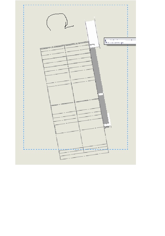

turning section view 90 degrees
being in dwg mode I made section view , is it possible to turn it 90 dg
thanks in advance ,
Answers 5
DG
DG 2010-02-10 Best Answer
Do you want to move the view or the actual section. Can you post a screen shot mentioning what you need.
SF
SF 2010-02-10
Yes, we do this regularly.  Simply right-click the new view and select Rotate View.  We also break the alignment and position the views in another part of the sheet (or even on a separate sheet).
Brian
SF
SF 2010-02-10
want that section have on sheet turned 90 (for print ) to make dwg clearer
SF
SF 2010-02-10
thanks ,
I need the same sheet not separate  , but thanks anyway
works fine and looks on blueprint too  , I hope option "normal to" also is applicable
DG
DG 2010-02-10
Brian method should work for you. Just click on the view and hit rotate and key in the angle value.
