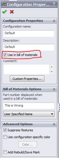

I was wondering if anyone knew a way to uncheck the "Use in bill of materials" option in the configuration properties. I know how to turn it on, but i need to turn it off.

Not quite, I want to avoid the description in configuration overriding the description in the properties which will happen if that box is checked. I want to have the box unchecked with a macro.

Hi Trevor,
ModelDoc2::EditConfiguration3
swConfigOption_UseAlternateName
swmodel.EditConfiguration3("Default", "Default", "", "", swConfigOption_UseAlternateName)
Modify the code in your macro and see the result.

Thanks Joseph! I am close now. I've got the option correct but can't get it to set false.
swModel.EditConfiguration3 defaultConfig, "", "", "", swConfigOption_UseDescriptionInBOM = False

Just use zero:
swModel.EditConfiguration3 defaultConfig, "", "", "", 0
The options for swConfigurationOptions2_e only get turned on if you specify them. So by missing them out, you are setting them to false.
