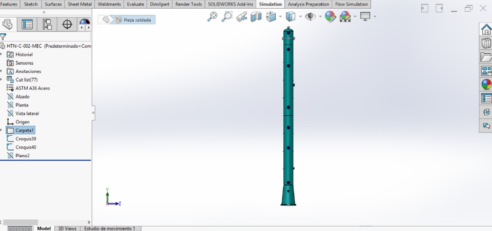

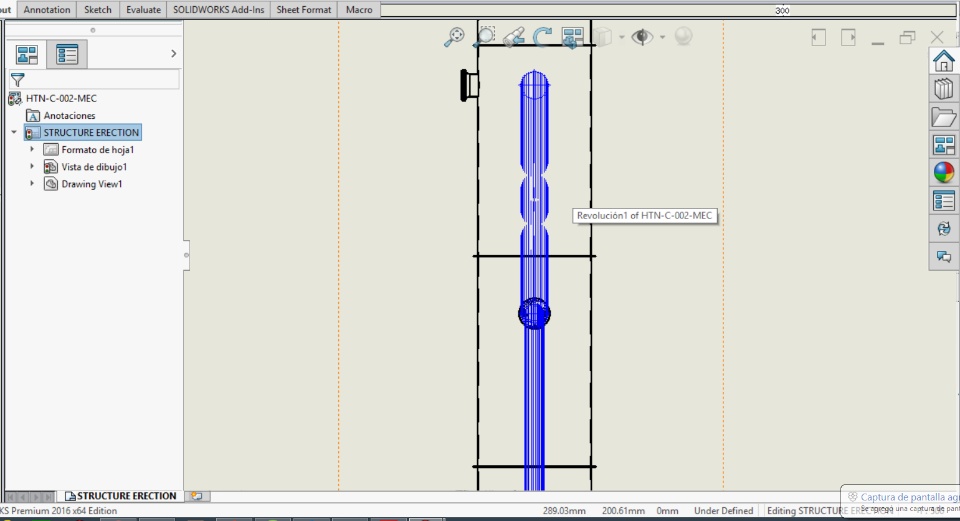

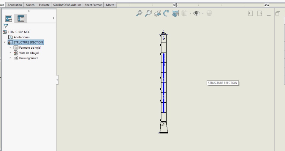

I have this problem: when I open a drawing from this part, the view show me this extended blue lines:

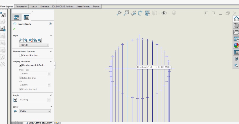

When I click on them, the Center Mark dialog menu appears, but I don't know what option is the appropiate to turn off the lines.
This is the part.

GS 2016-05-12 Best Answer
It looks like you may have Temporary Axes turned on.

Can the blue lines be deleted (like a center-mark)? The fact that they are blue makes me think they could be Axis lines (which are blue in drawings) but that doesn't make sense looking at your geometry.
SS
SS 2016-05-13
Hi, Sarah. The solution was exactly uncheck the Conection Lines to hole patterns with center marks. Thanks very much.
