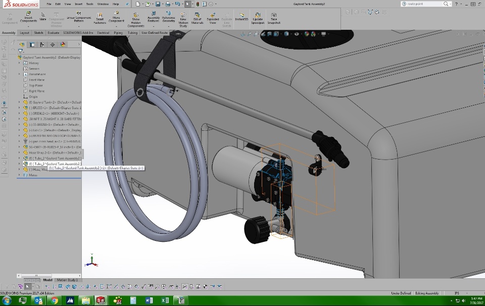

When I finish a Tube Route, a part is created in the Assembly Tree, and I can edit it, remove it, etc, I just can't actually SEE it.
See attached picture for what I mean. Could this be a graphics card issue? My coworker can open the same model and see the tubes just fine. His computer is actually 3 years older than mine and has a different graphics card, though I'm not sure what it is.

Dear Mr. Justin
have you tried upgrading your graphic card drivers??
Also try running in safe modes using SolidWorks Rx
If possible, try to share the files

Thanks for replying.
I've tried every graphics driver recommended by SolidWorks.
I don't know what happened, but all of a sudden the feature is working now.
Thanks again, though!

HI,Mr justin
1.just create a new routing in the open assembly,see if it can be selected  in the graphic area,
2.then make a section view in this routing then see if  you can see this routing.
if you can suffer the same experience,  you are the same with me, i'm experienced with it but i can see in graphic area but can't select. if you reopen it ,then this new routing can be select.maybe it's this version's bug.
