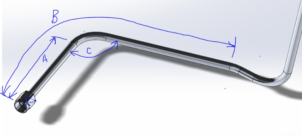

I thought the best way to generate this table in a drawing was to assign custom properties in the model, however I cannot figure out how to assign the length from the baseline to each bend. In other words, in my attached photo (please excuse my poorly drawn markup), I need to be able to assign the length shown as B to a custom property. Can you help me do this?

Can you explain to me how I can get the dimension "B" shown in my attached photo? Please note that this dimension is not the overall length of the tube, but the location of a bend at some point in the middle of the tube.

the BOM will only give you the total length of the piece of tube. If you are looking for a linear value like the picture i'd guess you'd have to measure the route sketch like the picture and show it manually
