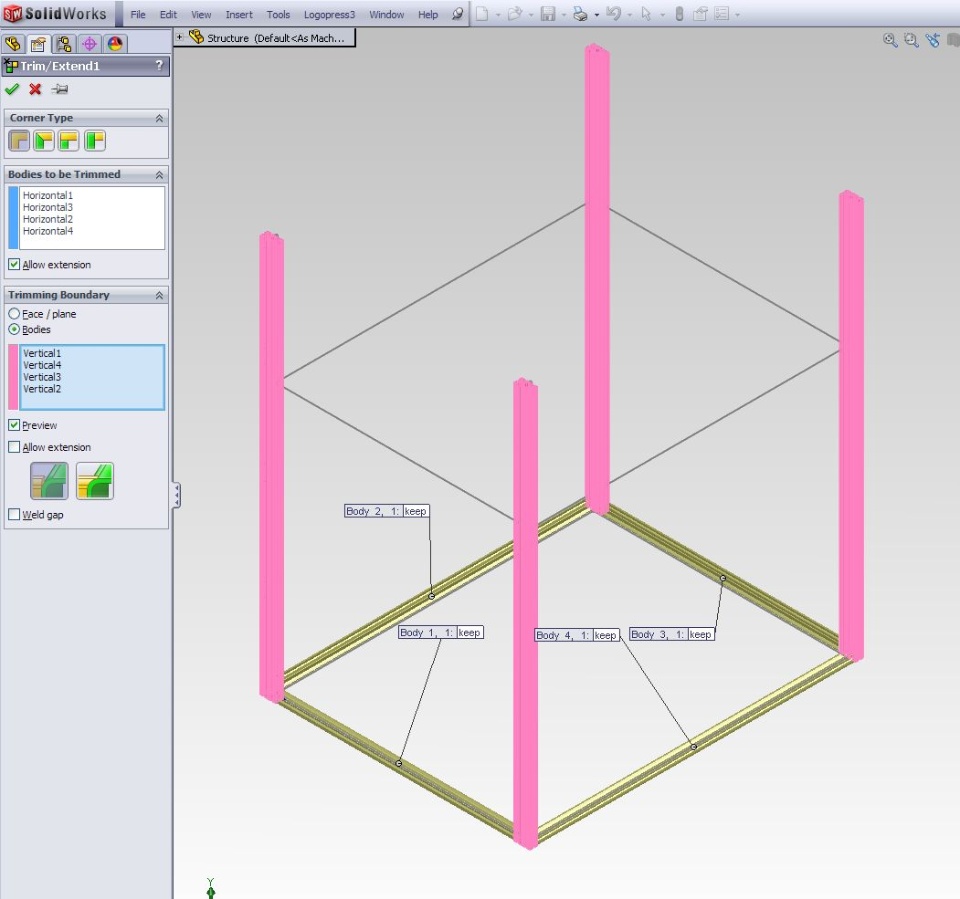

I'm trying to build a structure with 80/20 aluminum extrusions using SW weldments.  I've created the two profiles I need to use, and started building the structure, but have run into some problems.  Refer to the attached file.  I've included my profiles.
1. The trim/extend tool doesn't give me the result I want:
a. I trimmed the body Horizontal1 using the body Vertical1 as the trimming body which seemed to work, except that Horizontal1 extended into the centre of the Vertical1 even when I select 'simple cut between bodies'.
b. When I then try to trim Horizontal1 using Vertical2 it says the operation fails due to geometric condition.
2. I can't get the weldment cut list to update!  Even before trying the trim/extends...
Where did I go wrong?
I'm using SW2009 SP4.0.

Works great for me with SW2011-SP4. See attachment for settings.

Ok, I can get it to do the trims properly now (using faces), thanks!
But I still can't get the weldment cut list to update... any ideas?
SF
SF 2011-09-28
I just figured it out!  I couldn't update the cut list because I had one body rolled back.  Once I unrolled back, then deleted that body, it let me update.

Use the Corner Type > End Trim Option instead of the End Butt option.
See the attached image in my first reply.
