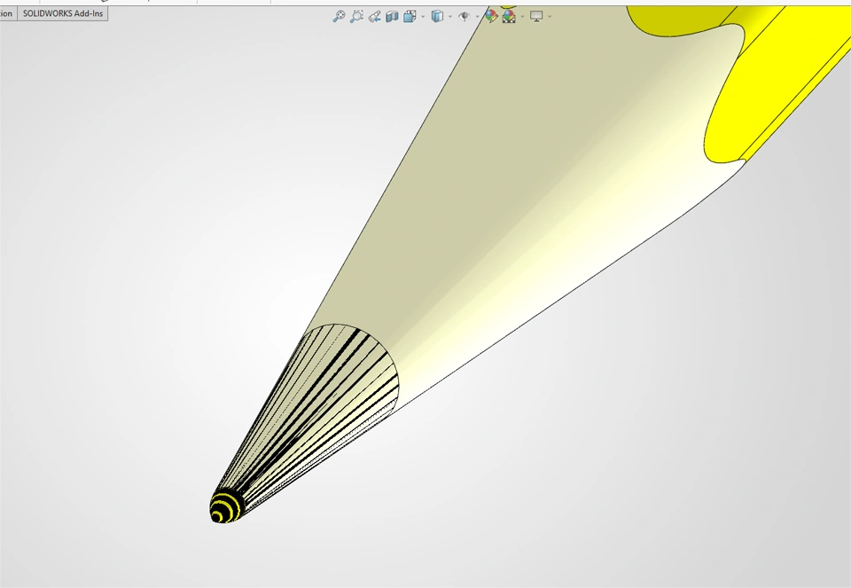

Hi. I am trying to figure out why the very tip of this pencil has these stripes on it? It should be black. If anyone has some ideas as to what I could do please let me know. Thank you.

This is a case of what we call "z-fight" here caused by coplanar black and yellow facets : depending on view orientation and zoom level, you will see "dancing" pixel level artifact flickering either yellow or black because the depth values are "almost" identical for the 2 coplanar geometry. Depending on view and projection, the test to decide which one is on top (done at GPU level with what we call depth test) is not deterministic in that case.
"Optimize for thin part" will only hep with edges that would be "behind" and that we filter out, but not for coplanar solid geometry facets.
To avoid this, you could "cut" the yellow tip cone, and only display its black version to avoid overlapping of any geometry.
did you have 2 surfaces or boby superposed on same faces ?
