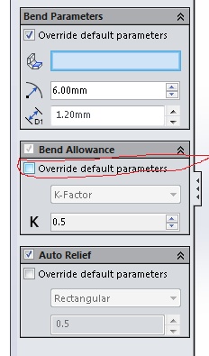

Trying to override default parameter of kfactor in bend custom bend inside sheet metal feature?
I'm trying to toggle to true the override default parameter of the bend allowance box of the sheet metal features inside the sheet metal folder.
I thought I could a property to do this inside the custom bend allownce but there is no such thing in the api.

In your code why is this line:
   'FeatureData.UseDefaultBendAllowance = False
been commented out?
I think that's the line I've been missing?

I was able to change the kfactor of the sheet metal features inside the sheet metal folder by the ISheetMetalFolder.
Here's an excerpt of my code:
<p>FeatureManager swFeatureManager = swModelDoc.FeatureManager;</p><p>                var swFeatures = swFeatureManager.GetFeatures(false);</p><p>                var swSheetMetalFolder = (SheetMetalFolder)swFeatureManager.GetSheetMetalFolder();</p><p>                if (!(swSheetMetalFolder == null))</p><p>                {</p><p>                    Feature swSheetMetalFolderFeature = swSheetMetalFolder.GetFeature();       </p><p>                    SheetMetalFeatureData swSheetMetalFeatureDataFromFolder = swSheetMetalFolderFeature.GetDefinition();</p><p>                    CustomBendAllowance swCustomBendAllowance = swSheetMetalFeatureDataFromFolder.GetCustomBendAllowance();</p><p>                    swCustomBendAllowance.Type = (int)swBendAllowanceTypes_e.swBendAllowanceKFactor;</p><p>                    swCustomBendAllowance.KFactor = (double)KFactor;</p><p>                    swSheetMetalFeatureDataFromFolder.SetCustomBendAllowance(swCustomBendAllowance);</p><p>                    bool FeatureResult = swSheetMetalFolderFeature.ModifyDefinition((object)swSheetMetalFeatureDataFromFolder, swModelDoc, null);}</p>
Thanks for the help Alex !
