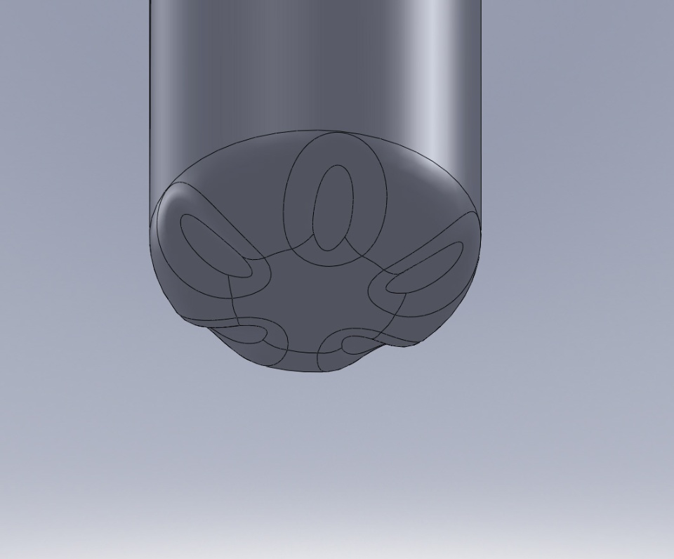

Trying to model a soda bottle.
Actually, its a 3' tall by 1' diameter canister with a molded bottom much like a liter soda bottle and that's the part that's giving me fits. Below is the best I've been able to come up with which I did with just some simple cuts and fillets. Anyone have a better idea how to go about it?

Darren, remove material once and then do a circular pattern.

Try this.  I don't remember where I got this model, but I think it's what you are looking for.

That's a beauty. I should be able to deconstruct that and get it done.
Thanks!

Darren, do you have a specific bottle shape you are trying to make.  There are several ways to approach this problem.  You can use Split and split the face of your surface, then use Free Form to pull some control points.   You could make boundary patches using the same split method and creating some control curves as well.  Here is a quick example(going off memory of the bottom of a bottle).  I broke the surface up into 1/4 sections since it was a repeating feature.  This could be done after the rest of the bottle was creating by using Zero offset surfaces after the split and deleting the original face so you can knit an array feature back in.  You can array the split, delete face i believe.
