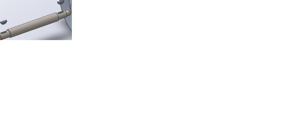

Trying to make Woodruff Key shaped hole?
Hey guys how Do I make the half circle shaped hole on the shaft as shown? (Woodruff Key #606)
I tried hole wizard or extrude-cut but I feel like I'm doing something wrong...

If you don't already have one, create a plane thru the axis of your shaft and make a midplane cut of the correct profile.  In all likelihood your shaft is a revolve and you can simply use the same plane you used for the revolve sketch.

Thank you for the answer. I actually did that before, I created extra plane by offsetting it to the middle of the shaft. After I made the shape and tried to extrude-cut it and I tried to control the length of cut (the right and left horizontal length controlling). But whenever I click the arrow, it just turns purple and won't move...

Make sure your sketch will be outside of the shaft diameter or use a full circle, I always use a full circle.

Can you attach your *.sldprt file here?
Maybe something like this?  (see attached)
