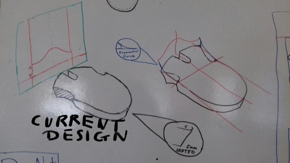

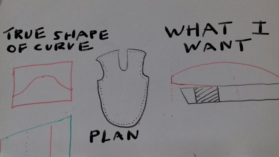

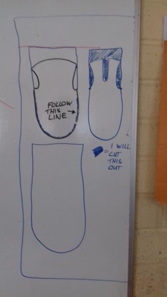

For my project I'm trying to make a computer mouse that's based off the Razer Naga, but the curve is proving difficult. Since it would be near impossible to describe using words, I'm including some images I drew to try and explain it.

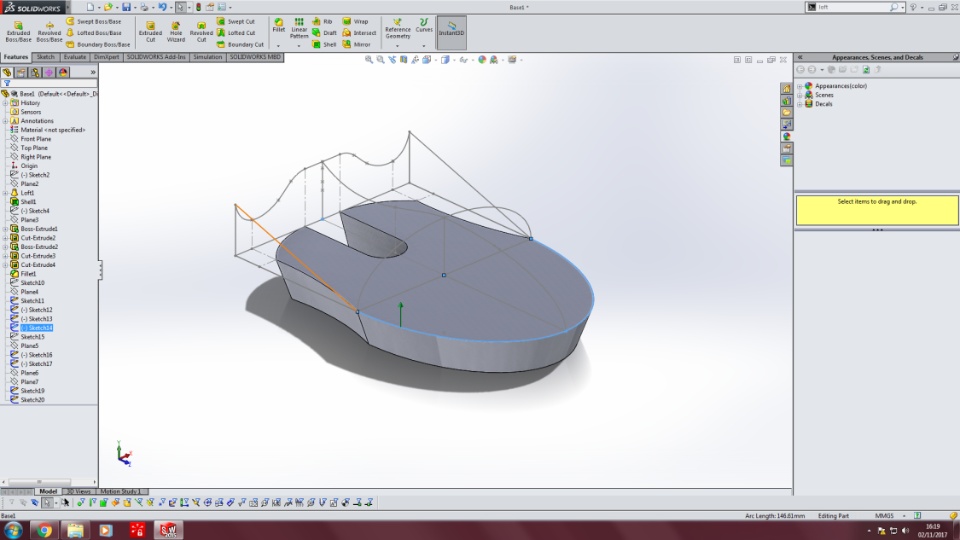

Thanks for the help friend, but the problem I'm having at the moment is that Plane 2 and the "spline" that you created in step 3 are sort of the same thing. As you can see in this image, the blue and the orange lines are Plane 2 and the spline so it's not working properly.
