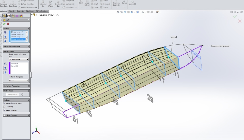

Having an issue with lofting a boat hull. I saw a youtube video doing it the same way and it worked flawlessly for him (as always!) but I can't get it to work for me. I've attached a screenshot showing the frames geometry and lofting guide curves. How come it won't fill in at the bow or stern and stops at the last frame geometry provided and doesn't fill into the guide curve?

Add profiles (sketches) in the bow and the stern. From the look of it you do not have any profiles there.

Thanks for your reply. How should the sketches be placed? I have a profile sketch at plane 24 as shown in the above attachment. How can I get it to close to the point on the bow, or is this just an option I haven't selected. This video shows what I am trying to do and he doesn't have any more sketch geometry than I do.

He has a center ridge, keel and outer ridge with a few section profile sketches like mine. Thanks!

     Looks like he has an point in the sketch "rib 0", you can select the same point for your bow or make a sketch with only one point.  And he does have one more sketch to select for the stern.

Thank you, I am still learning about more lofted geometrical modeling techniques and I did not know you could do a sketch point to drive the end point. Works well now! He must have omitted that from the video or I missed it.
