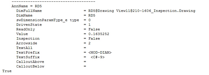

when i use this code block to test
I get this output
the Inspection is always false even though I have dimensions that have the been marked as inspection type

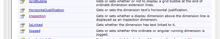

the API help says this
so i'm puzzeled as to why this is not working I use SW2014 for testing and will move this macro to SW2015 and SW2016 soon. I want to do this because the Solidworks inspection software is to expensive for our little company!

Have checked this code on Solidworks 2015 and soliworks 2016 and it seem to work fine. so there must be a bug in SW2014.
