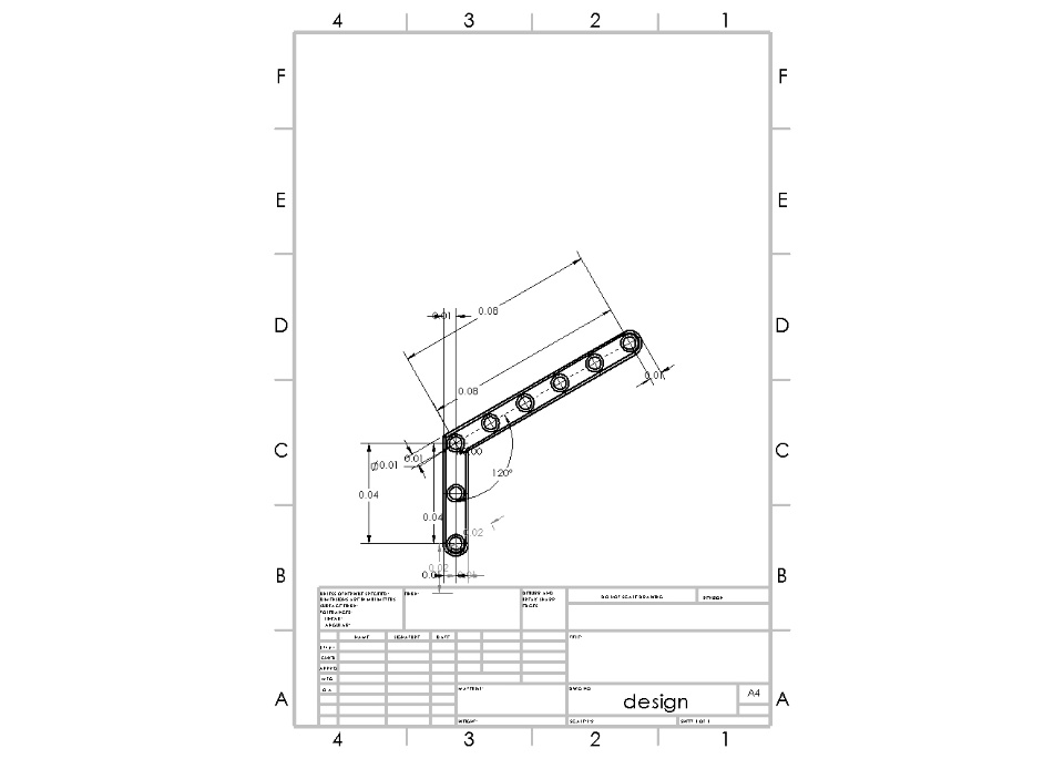

Trying hard to create curve driven pattern in api 2020, it is not selecting edge to specify the direction I guess.
So basically, Trying to create this type of design using API from Visual Basic, Following are the steps:
  1. Create geometrically lines A, B sketch intersecting at origin
  2. create bi-directional offset
  3. extrude the offset
  4. generate a hole at origin
  5. curve driven pattern to produce the number of holes.
  6. Applying Fillet.
The problem is at No.5 as per my assessment, I am unable to select the edge to run the pattern. Highlighted the relevant code in Red.
