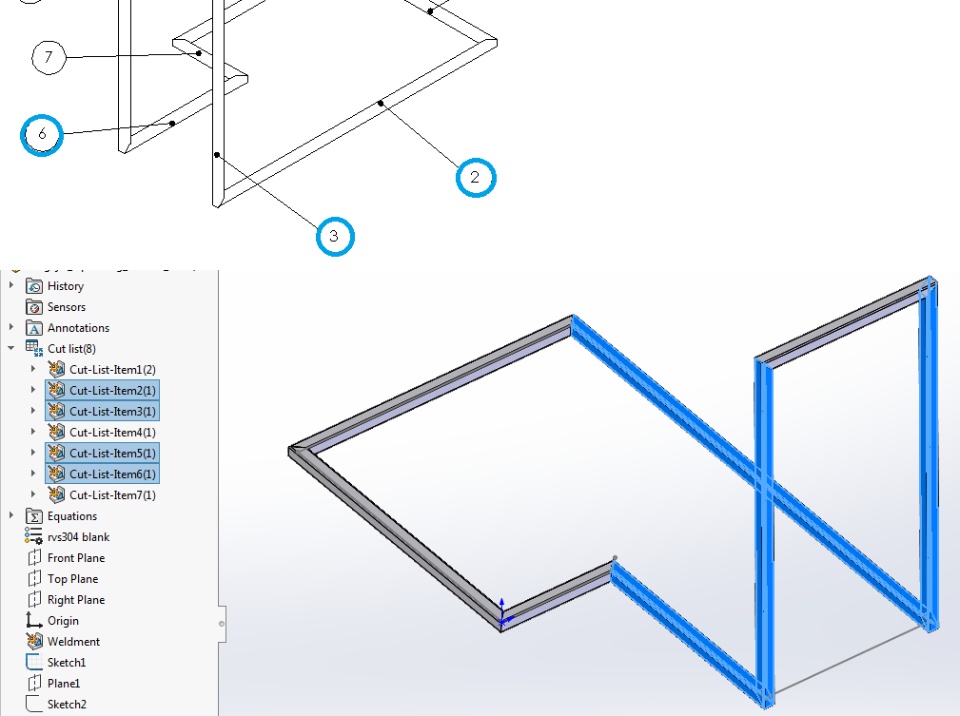

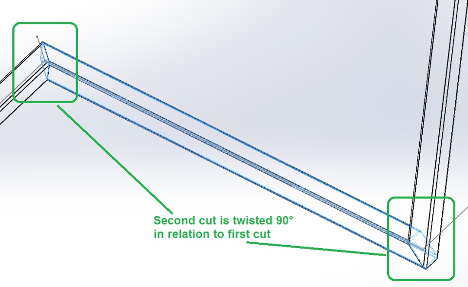

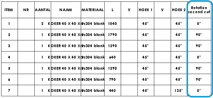

Can somebody please point me in the right direction for a macro that traverses a weldment cut list and for each profile in the cut list look at both ends of the profile to check their angles. Check if their angles are according to the same plane or twisted/rotated 90° and also if the angles are 45° or 135°

I saw your reaction about this on an other post and realized that this is not simple but our draftsmen have to figure this our for every frame they draw and I would like to assist them with this with API so that they don't lose time and sleep over this. If you have further information about this and are willing to share I would be most grateful.

That is a very steep hill to climb. A rectangular profile can have 10 possible permutations.
Gettting the angle is your least worry. How it relates to your profile sketch is the hard part.
Now throw in different style profile i.e. rounds and you can see how this will get out of hand quickly.
Cut saws that can do angled cuts in both horizontal and vertical plane have
often different cut limits per plane. That means some profile you need
to lay down with the long side while others you laydown short side.
Especially if you cut multiples...really hard task to organize.

Not really sure how to interpret the immediate window results. Are the 3 angles referring to X,Y and Z?
How can the twisted cuts be interpreted?
The macro does not traverse every profile and I can not find how to get the correct results by traversing through the whole body. Only the first 7 profiles are traversed and not all 8.

Myself I was thinking more in the line of traversing through the entire cut list and for each part in that cut list comparing the start and end face of the profile in relation to themselves and to the sketch line it originated from. But also this sounds a bit more like magic then reality to me now.
