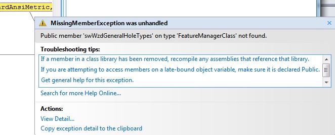

I'm trying to follow an example but am not sure how to address the error:
The code that was copied is shown below.  The error is shown at the bottom.
Any ideas how to fix this are very appreciated.  Any explanation of the "bigger picture" would also be very helpful.... thank you.

       swFeat = swFeatMgr.HoleWizard5(swFeatMgr.swWzdGeneralHoleTypes.swWzdCounterSink, swModel.swWzdHoleStandards.swStandardAnsiMetric, swModel.swWzdHoleStandardFastenerTypes.swStandardAnsiMetricFlatHead82, "M2", swModel.swEndConditions.swEndCondThroughAll, 0.0102, 0.010312189893273, 0, 0.0044, 1.57079632679489, 0.000152189893272978, 0, 2.05948851735331, 0, 0, 0, 1, 0, 0, 0, "", False, True, True, True, True, False)
