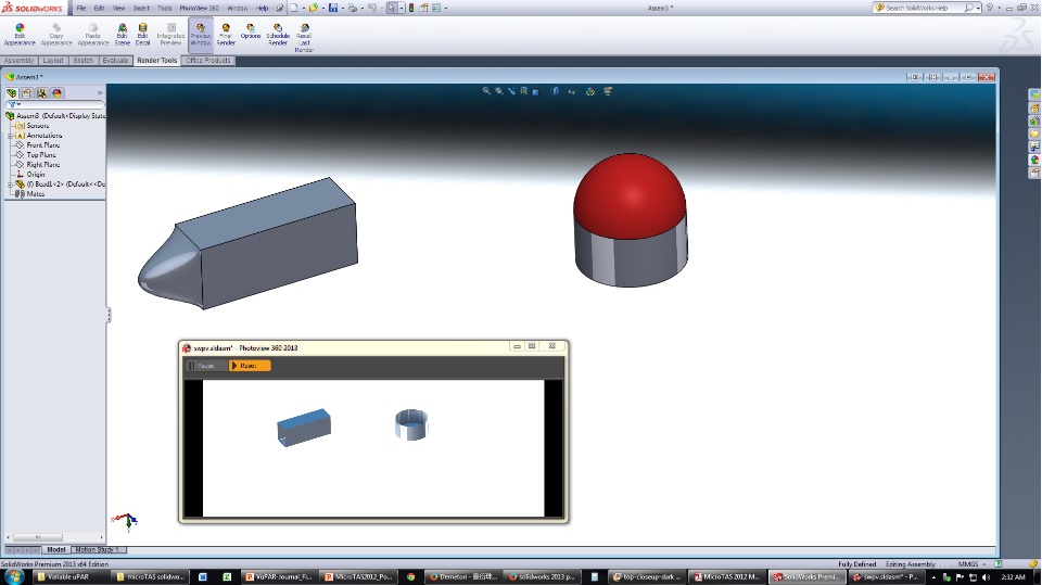

Hi, I'm not sure why, but any curves included in my model show up normally, but will not render in Photoview 360. I have attached a picture of what I am seeing. Any help is greatly appreciated.

I beleive there is something else happening here. It may have to do with the Dome and Deform feature surface not exporting properly out of SolidWorks into PV360.
What are you render settings? Good, Better, Best, Max? What are your Image Quality settings in Document Properties? Crank them up higher.
Can you post your file for us to look at? Use the Advanced Editor link in the upper right of the dialog box.

Hi everyone,
Thank you for the helpful advice! I have attached the file that I was using (Bead1) as well another file with a sphere that renders properly (microbead). I have spent some time working through it, and it looks like the main issue is that I was making the structures far too small for the rendering program (the sizes are around 10-20 um - .01-.02 mm). For whatever reason, scaling them up (by about 100X) appears to fix the issue. Is there something implicitly tricky about rendering microscale components?

That is your problem, microns or nanometers scale features. The PV360 engine does not work with features that small.
Just like there is an upper limit to the model size, there is also a lower limit. You will find a lower limit in SolidWorks as well.
You will need to scale your models accordingly if you want to render.
