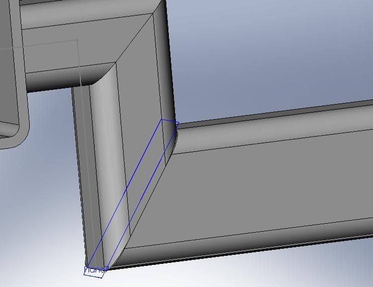

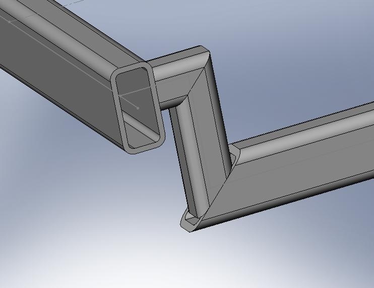

Trying to use "Trim, extend" feature to make corner of two different sizes members. Is that possible to use this feature for members wich are not same profile? If not, then how do I do it properly?
Please help, I spent half a day trying to figure out how to do it properly.

DG 2010-01-11 Best Answer
If you looking for somthing shown in your picture, it can be done easily using the Trim/ Extend option. But if you need something that will will cover the remaining open portion, then in that case you need to make that manually or use end cap and then cut of the inner portion.

I just did what I need manually. Created curve in between bodies, created plane, split bodies by plane, delete remains. Is any different way to do it faster and easier? The problem is that SW cuts members on angle which is half of existing angle - 45deg. But in this case it should be different angle. Because sides of members are not equal.

use cut-extrude thin.
see jpeg.

1. I still have SW2007, can I use one cut-extrude-thin procedure to cut both members? As I tried right now I can cut one at the time because they are in different cut directions.
2. After I make corner this way the "fillet bead" feature doesn't work! Is any ideas why?

1) yes, this is a basic cut.  the jpeg doesn't show correctly.  cut both bodies at once, you will then get an option about which bodies to keep.  notice the sketch is on the outer face of the tube.
2) welds are lacking.  if you really need, model it manually otherwise just use drawing to convey weld info.

Make sure you just cut extrude in one direction and use thin feature option. Don't select direction 2.
