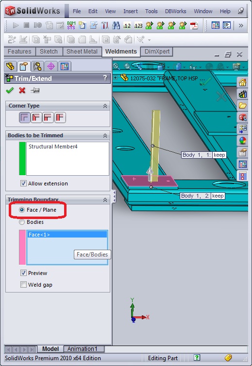

trim/extend - can only use weldment bodies
when i try to trim/extend a weldment using a thin revolve as a trim/extend tool, i get the error "only  bodies created by Weld Member Feature can be used"
i swear (in more ways than one) that i have used the exact same bodie ins this model to trim/extend weldments.
am i crazeee?
SolidworksWeldments
Answers 2
SF
SF 2011-06-08 Best Answer
Set Trimming Boundry to Face/Plane.
DA
DA 2011-06-08
well duh! that radio button was missing cuz i had not selected a corner type.
thanks for the hint.
