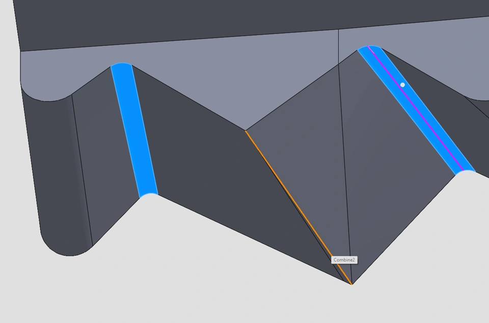

I have a rather usual geometry. Trianguar ribs that need a fillet. The fillet tool will not accept a radius on there, i imagine due to the other slither faces.
How can I fillet that edge?fillet
Depending on what you need for geometry, looks like you could do a delete face with the patch checked. This will extend the faces making the edge better for a fillet. However, not seeing the geometry fully and knowing you have a Combine to get this geometry it will change the shape slightly unless those faces are completely planar to each other.
Perhaps a lofted cut to emulate the fillet. Top and bottom face profile sketches of arc/ellipses/splines.
For guide curves, 3D sketches connecting each bottom endpoint to its corresponding top endpoint.
Similarly, create an extruded/loft surface and do a Cut with Surface.
Have you tried a face fillet? Chord length option.
If this is to be a bent part, use the sheetmetal tools. Draw and open sketch of the profile with the fillet in it and then extrude a base flange.
