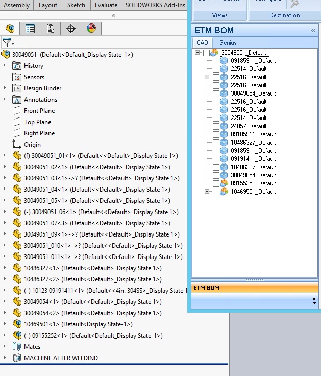

I have an assembly that is export to create a BOM but the order is wrong in so many level.
I saw the answer for with someone saying " If you do mind the order of the tree you will have to traverse on the features tree and look for components. The API help is not explaining that so let me know if you need help."
I need your help please.
Basically I have :

I saw 2014 SOLIDWORKS API Help - Traverse Features By Reverse Position Example (C#)  but don't know how to apply or use it to get the order and the parts.
Thank you for your help.
