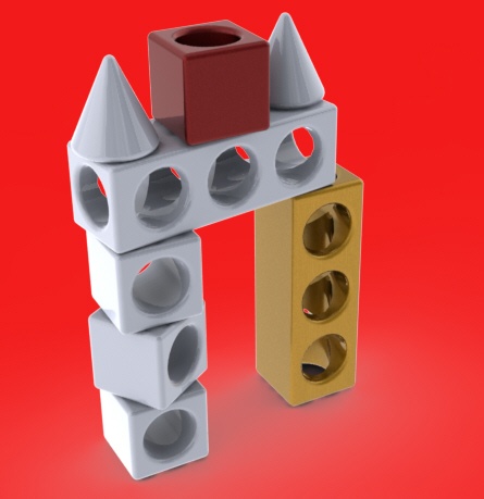

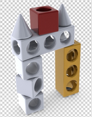

Hi! When I render to PNG, I get a nice transparent background as you can see below.
However, when I open it in Photoshop and put a (say) red layer underneath it, you can see the shadows are not truly transparent.
The result is the same if I render to Targa and use the alpha channel.

OK, I just got a reply from Rob Rodriguez that this is possible in Photoview 2010, just not in 2009 yet.
Daan

Well, I want to see shadows on the floor. I just want to be able to put any background behind them in Photoshop.
Daan
