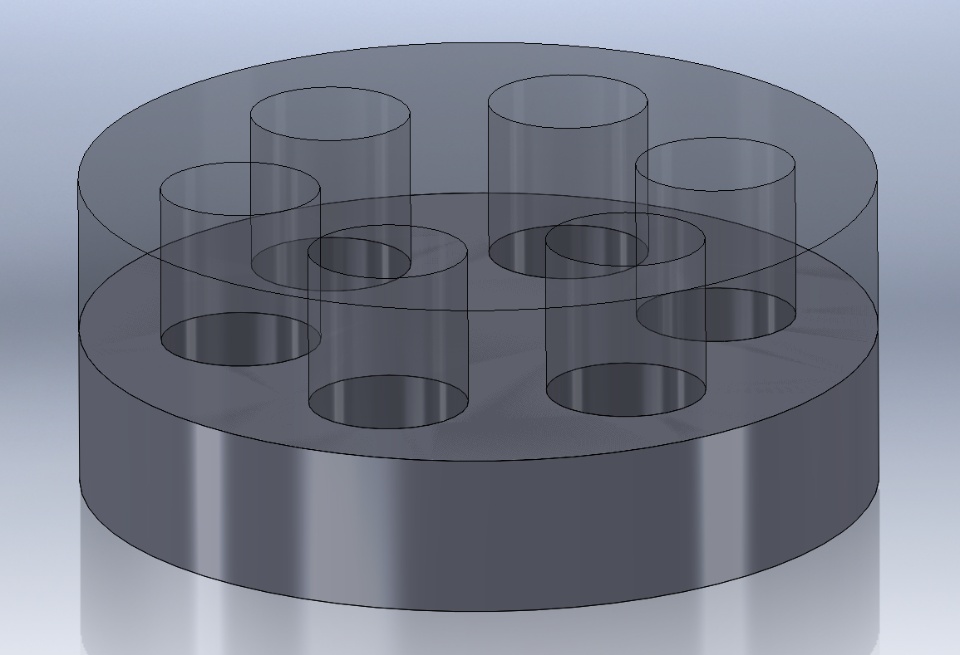

Hi there,
I've just upgraded SW2014 and i've noticed in assemblies when I make parts transparent the edges of the part go very thin and wiry. I dont remember this being the case in SW2013 and before and from watching some videos online other users edges maintain the same thickness as when not transparent. I've read transparency in 2014 has been changed so might be to do with that? I've tired out all the various options in the performance and image quality settings with no improvements. Attached an image for reference hopefully you can see what i'm talking about.
Something to note, i've just upgraded my PC including an upgrade of my GFX card from an ATI friepro 5800 to a W5000 which is one potential difference worth considering. I dont have SW2013 installed on this machine...but I guess that's an option to compare. Another option is to swap out the gfx card and see if it makes any difference.

Ok so yours is definately different...it's like mine is in a draft mode or something, i've tried all the various options in the settings, turned realview on/off etc can't seem to make it change....
We have another system in the offfice with the same issue, it also has the same GFX card so starting to think it might be linked to that, I have the latest certified drivers installed also.

What are your anti-aliasing settings under System Options > Display/Selection?  For Full Screen Anti-Aliasing (FSAA) you need to have SW launched with no files open to toggle that setting.
Get yourself on SP2 of SW2014 as well for best video card performance.
Lots of improvements in code in SW2014 to better take advantage of video cards.  Video card performance will scale higher with a better Quadro or FirePro video cards in SW2014.

Ok after some testing it turns out the graphics card (Firepro W5000) seems to be the issue. I installed my older Firepro V5800 which runs on the same drivers and setting etc and I dont experience the same issue. I have Anti-alias edges/sketches only enabled.
I'll install SP2.0 first thing monday and see if that makes any difference.
Thanks
AW
AW 2014-01-31
What driver are you using with your FirePro W5000?  I am assuming the 9.003.3 driver.
Try the 13.152.4 driver instead.
Also AMD will be coming out with some new drivers in the next 6-8 weeks.  They are a bit behind in driver development to take advantage of all the new code in SW2014.  They are working hard to address that.  Spent sometime chatting with them at SWW about their drvier development.  The power is in the cards, just need to tune the drivers a bit to take advantage of it with SolidWorks.

Well i've updated to SP2.0 and still have the same results, i've also just updated to the latest gfx card drivers too with no imporvement. I'm convinced it's to do with the actual hardware though as I do not get the same results when I use my older card with the same drivers/settings. Now that you mention it I also get the strange effect where coincident faces meet.

Edge quality issue occurs with the following setups -
Using SolidWorks 2014 SP2.0
Installed ATI W5000 with various versions of different drivers, both certified and newest versions - Edge issue apparent
Installed Quadro K2000 with various versions of different drivers, both certified and newest versions - Edge issue apparent
Here's the 1st inconsistency...I decided to install SolidWorks 2013 SP0 and to my surprise I do not get the same issues with either of these cards? So that rules out it being a hardware related issue...
Here's the 2nd inconsistency...I then installed my old Firepro V5800 and tested with SW2014...and again to my surprise I don't get the edge issues? So that rules out my SW settings being to blame...
So it's clearly some sort of compatibility issue between SW2014 and the ATI W5000 and Quadro K2000? Perhaps becauase these cards are a bit newer on the market and SW2014 isnt optimised yet..just a guess.
Has anyone else got either of these cards and using SW2014?
