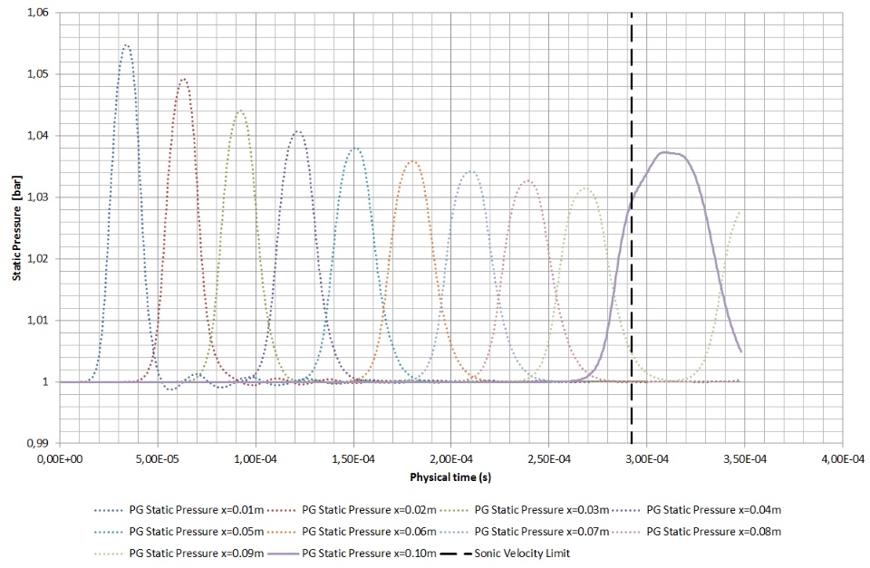

I recently stumbled over the following problem:
Test Case:
Consider a simple tube, closed at both ends. In my case it has a diameter of 4 mm and a length of about 0.1 m. If you introduce a small pressure impulse at one end the impulse will travel through the tube. The speed, at which the pressure disturbance advances, should equal the speed of sound of the medium. In my case the medium is air at a pressure of 1 bar (1E5 Pa) with a sonic velocity of about 330 m/s.
I set up a transient simulation with a local initial condition at one end, wich creates the initial pressure impulse of about 0.2 bar. After tweaking the time steps the impulse travels through the tube and is reflected at the opposing end, just as one would expect. At a sonic velocity of about 330 m/s the pressure impulse should travel the distance of 0.1 m in about 2.9E-4 seconds.
Problem:
The speed, at which the impulse travels, by far exceeds the sonic velocity by a factor of about 100. This does clearly not make sense from a physical point of view. The speed, at which the impulse moves can be influenced by the time-step and mesh setting to a small degree, but I never managed to come even close to the actual sonic velocity.
However, if I enable the "High Mach Number Flow" option, the pressure impulse travels at just the right speed. However, since the pressure impulse is small there does not occur supersonic flow, which basically means that the accuracy of the solution obtained this way should be pretty low.

Refine your mesh.  Keep refining until results don't change significantly.
SF
SF 2012-06-04
Thank you for that suggestion.
I've already varied the mesh over a wide range of resolutions but didn't notice any significant influence on the above mentioned issue. I'll try to increase the resolution even further, but don't think it will make a difference.
RS
RS 2012-06-04
Probably not necessary.  As long as you are getting convergence when the mesh is refined, that seems to show it's not the mesh.
Otherwise, comb through your material properties.  Could be a simple units conversion issueor misplaced decimal.
SF
SF 2012-06-04
This seems unlikely, since I used default fluid properties, but I'll double check my input parameters. Thanks for your effort!
