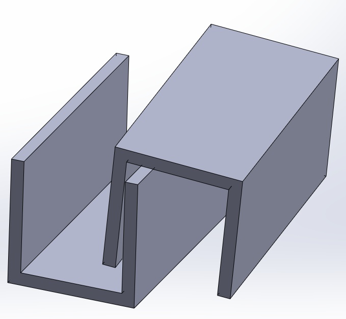

I have a simple assembly and wonder if it's possible to drag one part by moving another part
That is, if I drag the right part to the right, the left part will slide along. At the moment, the right part simply penetrates the left part. I've tried Move Component with collision detection, but it simply disallows moving if the two parts collide rather than letting the other part slide.

If you mate the edge of the vert. part to the surface of the other part they will drag together.

Do you have Physical Dynamics available.  This should do what you want.
