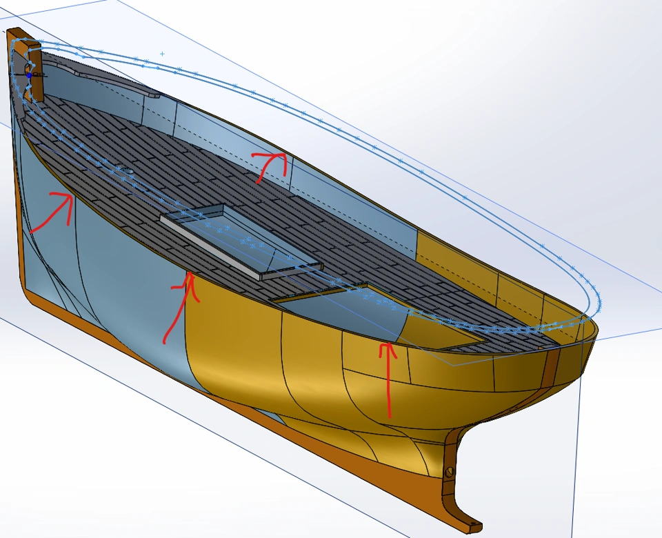

Hello,
 I've been trying to figure out how to transfer a shape from Sketch to the curved surface of a ship for three days now. I created a sketch on the plane and traced the shape of the ship from above. Now I would like to transfer this shape to curved surfaces (red arrows) and then extrude this shape. Can anyone advise me? I have tried various options in the surface and curve menus, but without success. Thank you.
Regards
Ales

You could use split line to project the sketch onto the surface and split the face. You can extrude off of that or just use a 3d sketch afterwards to convert that edge. You could also try project curve to project the curve onto the surface.
The likelihood of these working will depend on how nicely your sketches and surfaces line up

Try using the "Wrap" feature

Not sure if this is what you are after, but when looking at the side view, it looks as though the existing hull has a curve to it - if this is the case, create a surface that follows the curve and use that to create the shape.
(You can project your sketch to the surface and extrude from there.)

use project - curve to project a 2d sketch onto a 3d curved surface or surfaces

Hello, if you mean projecting with a split line - I used this, but since the outer shape follows the outline of the hull and the inner shape is wider than the width of the hull, it won't show up. I practiced letting this inner shape transfer to the deck of the ship, it did transfer and it was ok. I need to create a strip about 3 mm wider around the perimeter to replicate the ship's circumference.

Hello, yes, the side of the boat is curved. Do you mean the same method as posted - as a video tutorial - by John R. Sitek or yet another?

Hello, I tried to follow your instructions, but in the last step - Thicken - it gave me an error see attachment. The translation is probably - Area control has failed.
Unfortunately, I can't get SolidWorks Connected to be in English, even though I set the profile on https://eu1.iam.3dexperience.3ds.com/3DPassport/my-profile to English, it even requested a Windows restart after starting, saying that the preferred language had changed, but it still runs in my native language.
I am also attaching a Sketch I created that I would like to have alongside the ship. As another possibility I thought of
- create a Plane on the keel
- create a Sketch on this Plane
- transfer the upper hull shape to this Sketch, and make a 3 mm offset
- make an Extrude to the maximum width of the ship on this Sketch
- use the Sketch I created and make an Extrude Cut with it - first the outline of the ship (arrow 1 in the attachment) and then as a second Extrude Cut the inner shape (arrow 2 in the attachment). It is clear that I would have to change this Sketch or derive another one from it. Thank you all for your help me.

Hello, I changed the Windows language version to English, restarted, started SolidWorks, run function Thicken and did this error - Unable to thicken surface. Regards Stritesky
