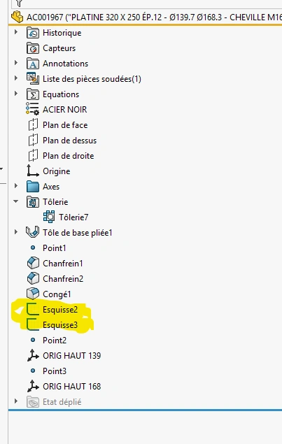

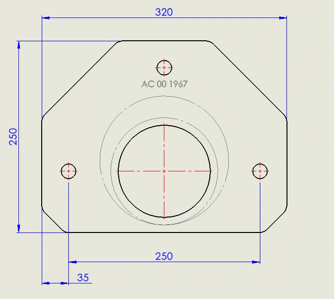

Je souhaiterais certains traits d'esquisse en couleur (verte)
Les deux cercles en traits discontinu ainsi que le AC 001967.
Ils sont créés en esquisse dans le 3D.
Merci par avance

"Colored Sketch Lines in a Drawing
Hello,
I would like certain sketch lines to appear in color (green):
The two dashed circles, as well as "AC 001967."
These were created as a sketch within the 3D model.
Thanks in advance."

You can select individual sketch entities in the drawing view and change their color with the Line Color icon in the Line Format toolbar.
comment imagecomment image
SM
SM 2026-03-25
Thank you for your quick replies.
It does indeed work for both circles; however, I don't have the option to assign a specific color to the text AC001967.
