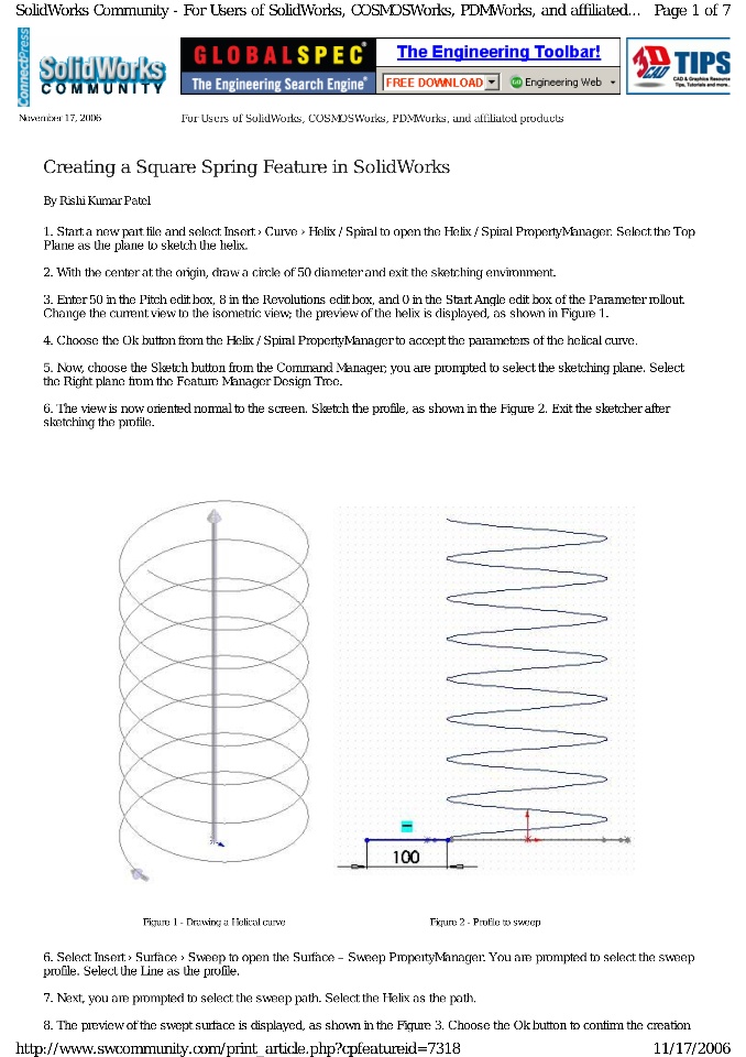

Welcome to SolidWorks forums Peter.
Check here as how to make a square spring and same logic will be used for the toroidal helix: http://www.solidworksthai.com/board/attachments/Sprial.pdf
Please use "advanced editor" in case you want to attach any files.
You might also find this post helpful for your future reference

TC
TC 2012-07-10
Deepak, I went to look at this but the entire PDF will not download, looks like it was 7 pages and I only got 5.
DG
DG 2012-07-10
Here you go
TC
TC 2012-07-10
Thanks

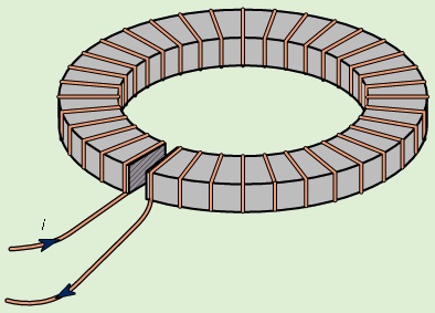

PR
PR 2012-07-11
Thanks for all of the great tips and advice.  I found that the best way that works for me is the one posted by Chris Challinor.
Try this http://www.youtube.com/watch?v=5rK6vA3qZO0
I was able to have a square shaped helix along a curve.  The final step was a Boss Extrude Sweep Feature which results in a single solid body coil that can be used for simulation.  It was a 10MB file though!
comment imagecomment image
