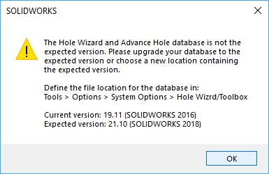

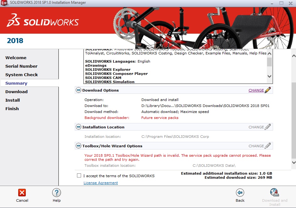

I am updating my installation from 2018 Preimium SP 0.1 to SP 1.0.  I am getting an error message saying that my toolbox path is is invalid.  Change the path to proceed.  Unfortunately, the CHANGE button is grayed out.  When I look at the path on the computer I get another error message saying the current version of Toolbox is 19 and the expected is 21.  Why didn't 21 load when I installed SW2018,0.1?
Anyway, is there a fix for this?

I've had problems like this when using mapped drives on a server for the toolbox. You might try changing the toolbox path to a dummy adress in the settings of SW before running the update.

This sort of blockage in the Installation Manager due to the Toolbox folder path is something we saw a lot of in version 2017.  Early service packs of 2017 (I believe SP3.0 and earlier) had no real fix which led to a lot of users uninstalling their current version of SOLIDWORKS in order to upgrade to a later version of SOLIDWORKS.  In later releases though there was an alternative where you could run a repair on SOLIDWORKS (via 'Programs and Features' in the Windows Control Panel) before then proceeding with the upgrade to the newer release.  This only seemed to work sometimes though.
In instances where i have personally seen this it has always proved a faster solution to uninstall the older version then install the anew.
