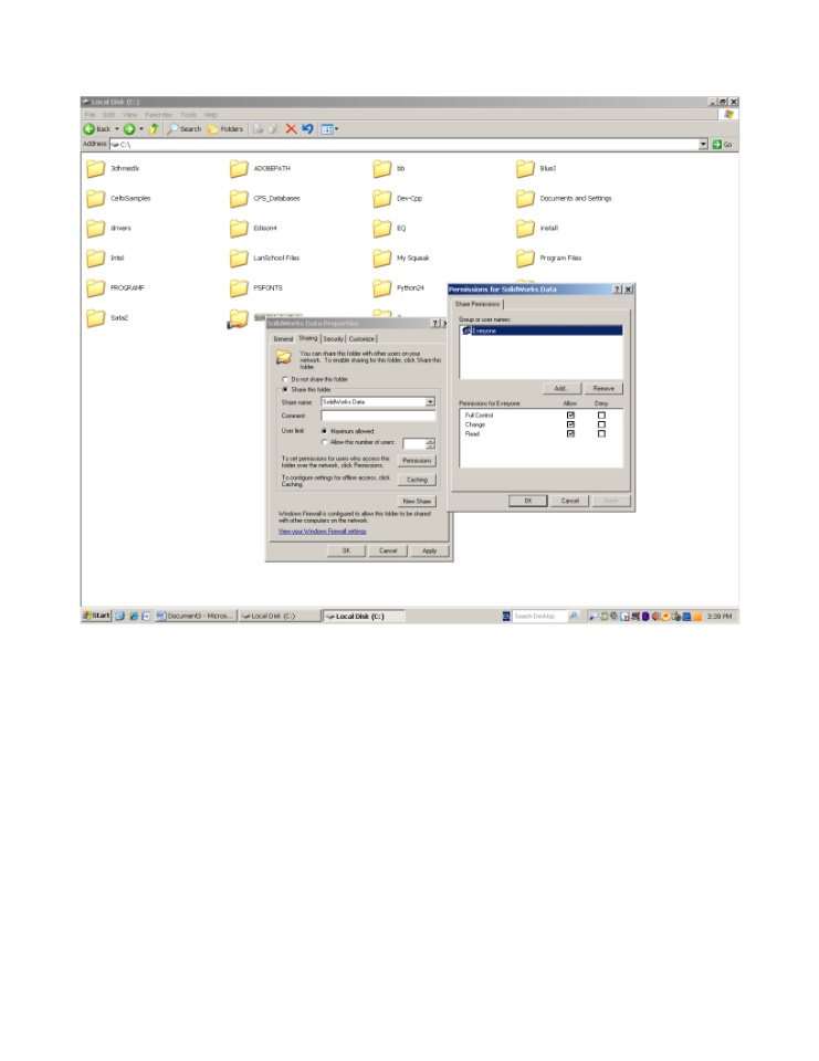

We followed those instructions, and set the permissions to everyone, and gave everyone full access. Those changes were visible when I logged back onto the same computer with my teacher log in.

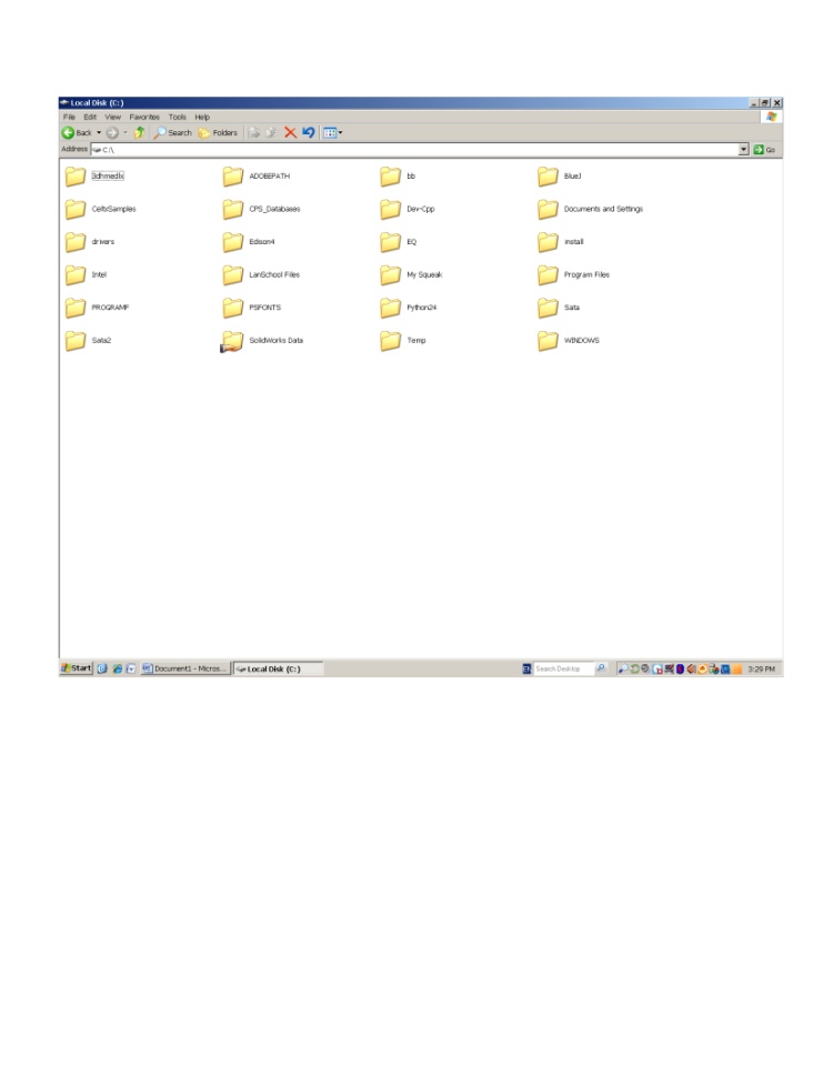

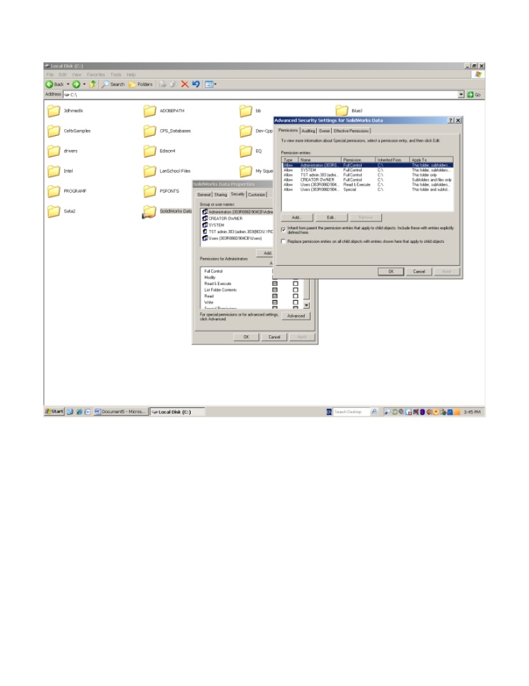

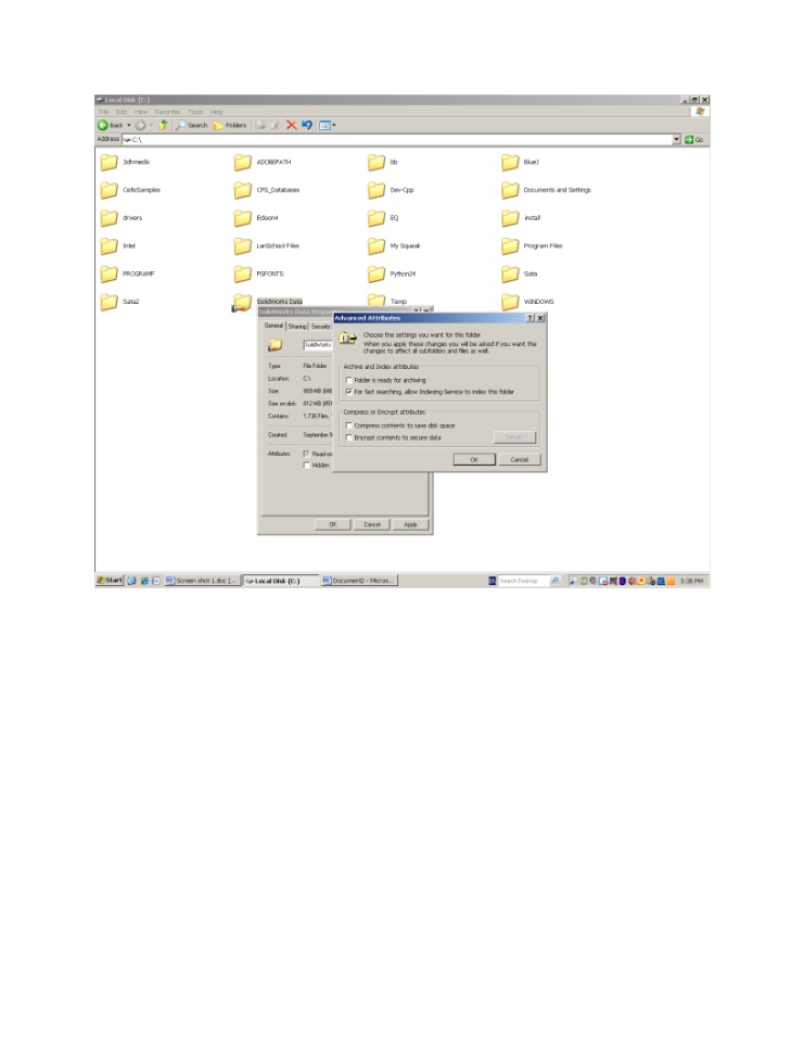

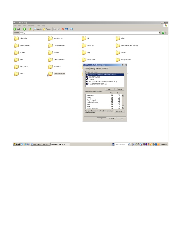

The only thing that I have found is in the C:\SolidWorks Data\Lang\English folder is a file called SWBrowser.mdb with the suffux Microsoft Access Database file, and a file called SWBrowser.mdbold
I have attached several screen shots if this helps.

We have managed to get the Toolbox working on our system. The issue was that there was another layer of permissions under the security tab in the properties manager of the SolidWorks Common Data folder. All users had to be given complete access again under the securities tab.
Once we did that everything works as advertised.
