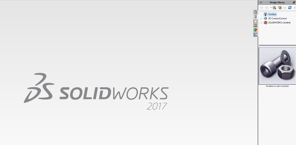

What happens when you click on that pile of fasteners?
HH
HH2017-09-29
It does not work and I did not install the toolbox
In add-in, there is no toolbox

AH
AH2017-09-29
This could be normal if you have a certain flavour of student version (one supplied by the University/College) as it will be SolidWorks Standard where Toolbox is not available.
Go to Tools > Add ins and see if it states SolidWorks Standard at the top.
HH
HH2017-09-29
The version I'm using is SolidWorks Standard Can you tell me how to install the toolbox?
AH
AH2017-09-29
You cannot. It is not available in SolidWorks Standard, only SolidWorks professional and Premium.
