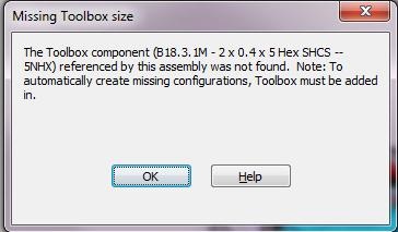

Hi all, and thanks for taking the time to consider my question. I need to open large assemblies that contain toolbox components. I am running a standard licence of solidworks which doesn't include toolbox. An error is caused ever ytime solidworks tries to open one of these toolbox components, see attached image. The end result is that I need to press escape many many times to clear these errors while the assembly opens. It's eating up large chunks of my day.
Does anyone know (a) of a way to clear these toolbox errors ,or (B) whether the Solidworks API can be used to handle these errors and automatically clear them? The macro would need to be running while the assembly is being opened. Is this even possible?

KR 2012-04-11 Best Answer
Hello Unspecified,
Try using ISldWorks::OpenDoc6 with the "swOpenDocOptions_Silent" option passed in the Options argument.  I haven't tested it in your situation but this option does prevent error messages and warnings from appearing, so it might do the trick.  Here's an example of how the VBA code would look with an assembly called "Assem1.SLDASM" that's located on your C:\.
swApp.OpenDoc6 "C:\Assem1.SLDASM", swDocASSEMBLY, swOpenDocOptions_Silent, Empty, Empty, Empty

Hi again Keith, it's me, Unspecified Unspecified
So, I followed your suggestion and used OpenDoc6. Just what I needed, thanks! Google led me to the ready made example here, so I'm in business. I do have a few additional queries, if you'll excuse my straying from the original question.
