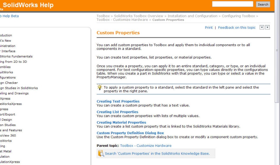

Vinod,
I found this inside of Solidworks help file.
I think this is what you are looking for.
Look at the attachment.
SF

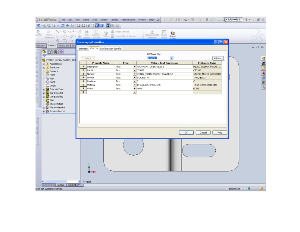

Scott hasn't done too bad reling on his memory.
What I do, is for each component of an assembly, in their properities, under configuration spacific tab place the PartNo, Description and whatever else you want to describe that component.
Then on the assembly drawing insert the BOM, double click on a column and under the dropdown box for Column Type select CUSTOM PROPERTY. Under Property name select the PartNo or Description etc.
