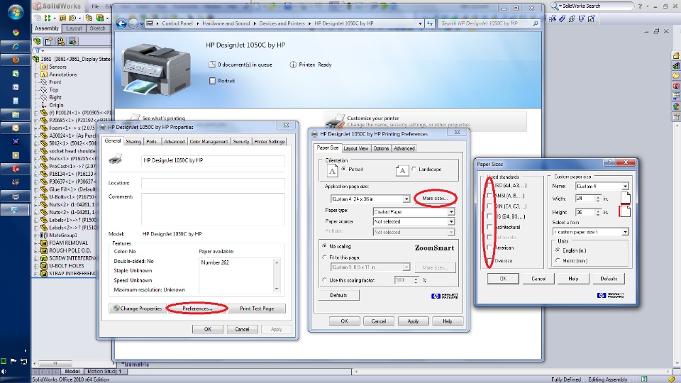

I'm sorry if this is in the wrong forum. Is there a way to get rid of printer size options we are not going to use?

Here's what I did to get rid of the extra sizes. Go to your paper sizes in your printer setup, through your printer preferences then more sizes, and uncheck all the user standards. Then, set the sizes you need in the custom sizes. All you will see for the printer you change the sizes for is the custom sizes you set up.
