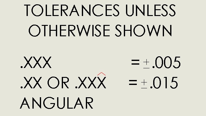

Our old Autocad drawings have an odd call-out in the tolerance block. Does anyone know what it means when there is a carrot over the last place as shown in my picture? I haven't really got a good answer from the engineers here and I haven't found anyting on the internet explaining it.

I have not seen the like before, but I see only one way to interpret it;
they wanted to be able to call out .XXX with +/-.005 most of the time, but to also routinely have .XXX +/-.015. so they can add that carrot to a .XXX dim to loosen it's tolerance with out adding the tolerance to each of them.
