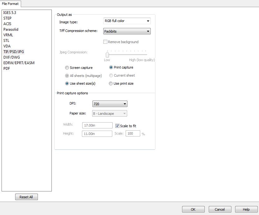

I need a macro that will save as Tiff.
I would like it to save the tiff in the same location as the slddrw file with out questions asked.
I don't want any options to come up like resolution or location or something.
Just a quick Tiff creator.
I will set the options (Resolution, multisheet, etc) beforehand.
I'll be Tiff-ing 1000's of files,

Attached are two macro to save drawing(s) as TIFF.
Save Drawing As TIFF.swp: Save Active Drawing as TIFF
Batch Save Drawing as TIFF.swp: Save drawings in the specified folder as TIFF
All the settings have been encoded in the macros so you just need to run and enjoy your coffee.
