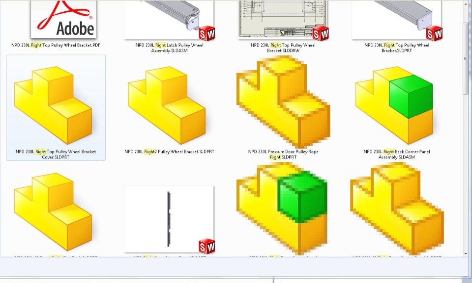

All documents rebuilt, thumbnails- icons showing preview, after checking documents into the vault, windows explorer or solidworks explorer previews disappear!
But the drawing thumbnails icons continue to show correctly.
In the attached snip there is some icons with jagged edges and some with nice straight edges.
Opening either of these up  does not prompt for a rebuild.
No messages in Options-advanced.
What do these different icons mean?

I had looked at both of those threads and neither relate to my problem.
The always show icons box is unticked.
If you look at the screen capture some icons do show, it is only the ones that are then checked into Pdmworks that revert back to icon instead of thumbnail views.

I have conducted some investigations and found the following.
All doucuments rebuilt and fully constrained and showing thumbnails.
If I check in the a part document that has a thumbnail image it works fine.
If I check in a sub assembly document that has two parts including the one already checked in, it fails.
The assembly document lose's it's thumbnail as well as the new part document. The already checked document keeps it's thumbnail.
I am going to do an RX and send it off as it must have something to do with Pdmworks.
