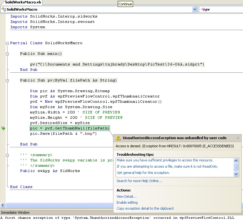

I thought I would go ahead and give your code a shot.  I'm using VBA.  I can't add a reference to the file you suggested.  When I try, I get the error message "Can't add a reference to the specified file."  This occurs whether trying to create a macro in SolidWorks or Excel.
JB
JB 2009-07-28
Jacob
I also tried your code in a VSTA VB.net macro.  Didn't work there either.  I was able to add the reference, but I got the error below:

What is the exact code you are running, can you paste/upload it and I will test it
JB
JB 2009-07-30
All the code is actually shown in the picture I uploaded.  I'll zip and post the entire VSTA macro folder in a little while though.

The project runs fine as is so it is a permissions issue for sure.
This begs the question though why use this messy way of getting an image? It doesn't even get a large image its actually smaller than using the built in SW functions to get an image, which gives it you at the last display resolution the model was open on... this way gets thumbnail size; for example set the size to 2000x2000 and see the giant pixels. Compare that with GetPreviewBitmap which is totally fine.
