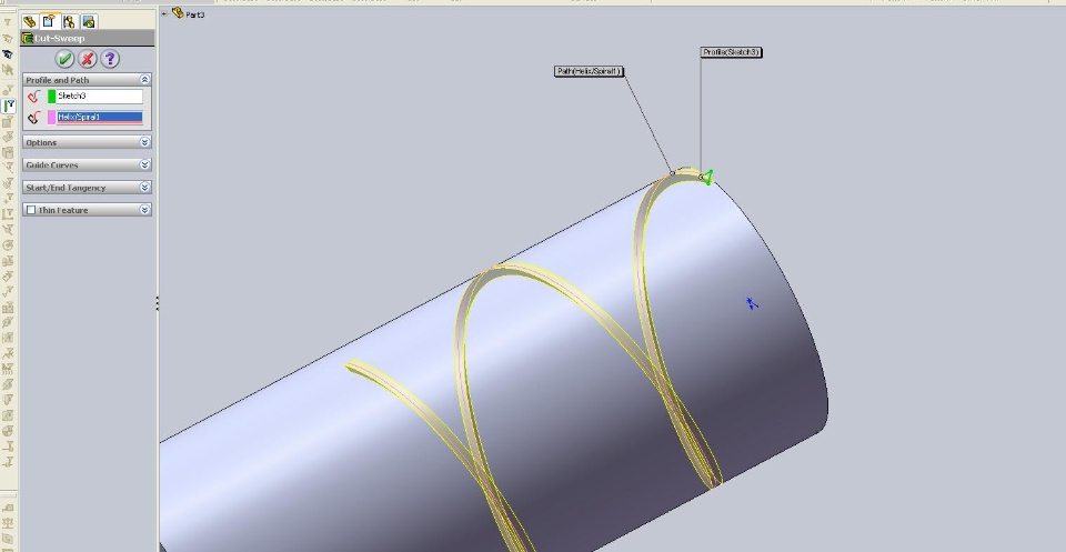

I have read about creating threads but I need a bit morehelp. I am starting with a cylinder and now i want to use the helixmethod to create external threads from top to bottom of thiscylinder. How do I make a helical curve on the surface of thecylinder?
Any help would be appreciated. I hope to use the part for finiteelement analysis when it is finished.SolidworksSketching

A plethora of methods. Create a helix by drawing a circle for theOD, then select it, and chose Insert>Curves>Helix/Spiral.Read the help file on helix for more information.
A note of caution. FEA analysis done on threads is not accurate.The "hand-calculated" models are far more accurate than any FEAmodel, which basically returns garbage. I suggest doing yourhomework on stress analysis over threaded fasteners, and just solveit that way.

Ok now I have the spiral, how do I choose it as a path for acut to follow?
SF
SF 2008-11-05
If you already have the profile of the thread sketched, justselect cut sweep (Insert>>Cut>>Sweep). First field youselect the profile and second one the path.
However, to make threads I prefer the Sweep Cut with the Option"twist along path". It rebuilds faster and the part is lighter thana thread with Spiral path.
