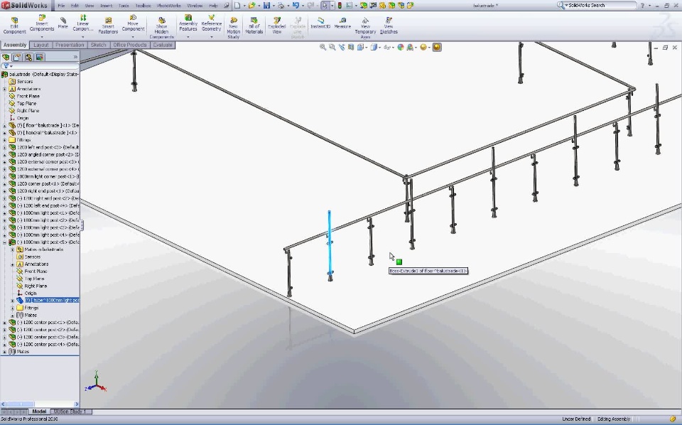

what is going on here? i mate these posts to the floor and rail so they are fully defined. i then try move a post to check it is unmovable. it doesnt move. fine. i then hit ctrl q and it comes up with a list of errors as long as my arm. ( see video). bearing in mind i had the whole thing nearly done when this started and i went as far as to delete all the posts and start again, but no luck. is it a bug, or what?
please help someone, or someones going to get hurt!

Need files to look at and come out to some conclusions.

Hi Greg,
Suggesting to look to the connection between posts and top horizontal beam. There the posts will start influencing each other. The less mates the better!

here is the file. the weird thing is this was fine right up to near completion, now its gone haywire! bearing in mind too that there is a lot more posts still to go in to this assembly.

for the first time you wont be able to help me!
ive just deleted all the mates and started again. trying to mate differently (), see how it goes this time.
