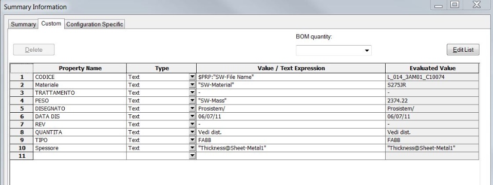

Hi,
I attached a mirrored sheetmetal part,with some properties compiled.As you can see the "Thickness@Sheet-Metal1" doesn't work of course.I know that converting the part to sheet metal is a solution,but i was wondering if someone has another solution.For example to get somehow the thickness from the parent part.
Thank you.

Good morning Doru,
You must first convert to sheet metal as the property manager is searching for "sheet metal" thickness not model thickness.
It is rather simple and it took me less then 30 seconds to select a face add sheet metal bends, (Not Convert To Sheet Metal), and then go to the property manager and see the results of 3mm.
Again it must have bends and sheet metal properties prior to calculating the information,
