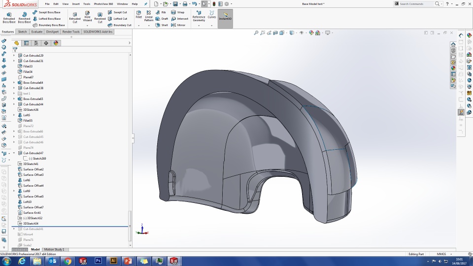

Hello, I am a placement student at a skate company with a Solid Works issue.
I have produced a skate helmet model however after after checking with the factory they have asked to thicken the outer helmet dimensions by 5mm offset and maintain the inner helmet dimensions.  I was wondering how to do this quickly as I have very limited time ?
A possible method I found of fixing this issue is ---
I have rolled back the model to when I had not put any holes into the helmet. I found you can offset the outer surface by 5mm to achieve a new surface. However when lofting to filling in the gap between the original outer surface and the new 5mm surface, I have small gaps between each of the surfaces.
Thankyou for all the help.
Jack

Hi Jack,
If you offset the outer surface by 0mm, you can then use the "Thicken" command to make the surface 5mm thicker. This could then merge with your existing solid.

Hi Iain,
Thanks for the response. I am able to offset the outer surface by 0mm, however when I try to thicken, I receive an error message stating unable to thicken.

IM 2017-08-15
It might be that there is a certain area that has too small a curvature to allow the thicken to happen. Would you be happy to share the model?

SE 2017-08-15
You may also try using the move face tool in the direct editing toolbar.

DS 2017-08-15
What will work, very much depends on just how the part was created.  May be able to simply edit an existing feature, may be able to roll back the model and use Move Face, may be something difficult to do....all depends on just how the part is modeled.
So...if you attach your model to your post, we may be able to be of more help.

TG 2017-08-15
One easy way to eliminate a tiny gap is to overlap bodies completely, then Merge or Combine. Since your part has workable depth, you can create two offsets on both sides of a surface, and a merging loft between those, or a combine of the overlapping bodies.

Hi Doug,
I am uanble to roll back further into the model as I worked from a 'base' model from the china factory. Essentially, the base of the helmet shaping was made already and my job was to put holes, air channels etc into the helmet. I would upload the file, however the company are not keen on me doing so. However, I can upload more screenshots if needed.

Thank you Trevor.
Have tried the move face tool with no success I am afraid.
