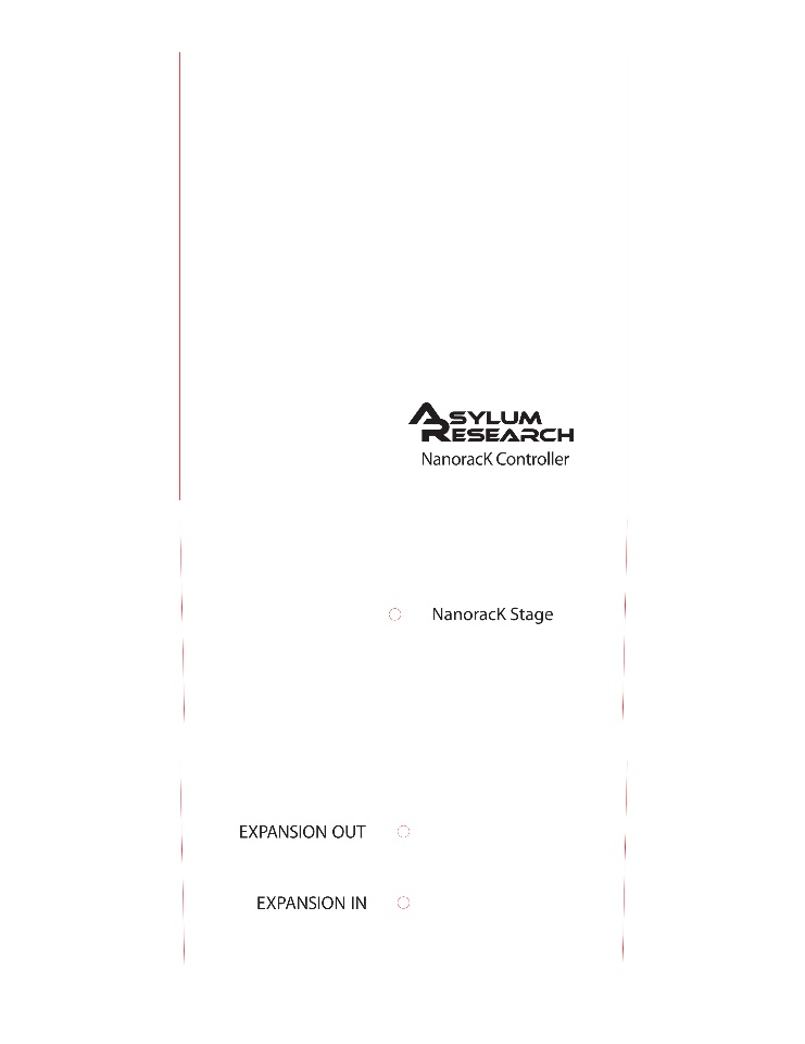

Our art department made a nice .pdf and .ai file of some artwork to be silkscreened onto my part.  When I try to insert this as an object onto Sheet 2 of my drawing, I get a "The Object Could Not Be Created" error.  When I convert the .pdf into a .png using Acrobat Pro I cannot insert it as an image (same error). However if I screengrab the .pdf and save as .png I can insert it, but that is horrible quality.
Any ideas on how to get this into my drawing? A search did not reveal anything.
Edit: added .pdf file if you'd like to try your hand.

You will have to convert the PDF to a JPEG and then insert it into the drawing. The quality comes out very nicely. There are free software out there that will allow you to do this.
PC
PC 2011-11-14
I actually have Adobe Acrobat Pro which allows me to export as .jpg, but when I try to import that into my Drawing, I get an error about it being an incompatible format and the import fails.  The .jpg opens fine in any viewer.
