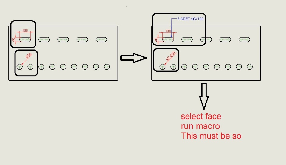

For Number of Holes, please use Hole Callout command, refer to attached video: HoleCallOut.wmv
For number of slots, there is not straightforward command, but there is a way to work around, please refer to attached video: NoteToDimensionLinking.wmv
It needs a few more steps, but the note for slots is parametric as it updates when the feature dimensions change.

hole wizard
This needs to be done
not for the holes made by apartment
circle sketch
no quantitiy
SL
SL2016-03-10
Yes, you can't use circle sketch, you have to use hole wizard feature.
hole wizard
circle sketch
no quantitiy

Thanks
Mark
no SolidWorks 2015
Do I need to have SolidWorks 2016 ?
Yes, this is a new feature in SOLIDWORKS 2016.
