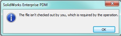

The file isn't checked out by you, which is required by the operation.
When I check in a sldprt file I want to update some attributes on the datacard belonging to the parentfile(slddrw). I'm using the api to achive this. Everything works fine except that I get this annoying window popping up telling me that 'The file isn't checked out by you, which is required by the operation'. Both the sldprt file and the parent file(slddrw) are checked in as they should and the datacard are also updated.
The following code handles the PreUnlock event.

Can anyone tell me what I'm doing wrong in this code.
